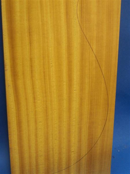

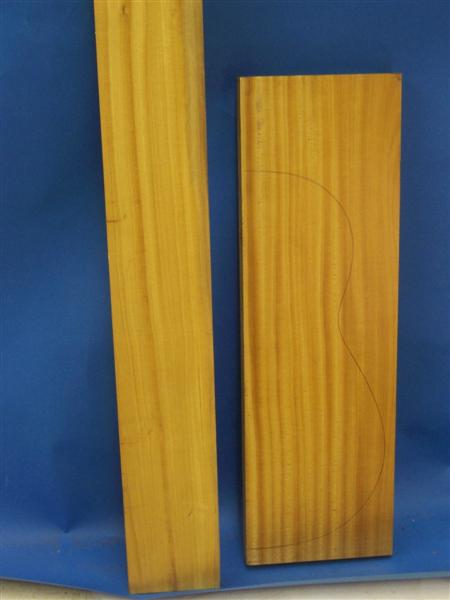

I don't think I can be more specific. I bought it at the ASIA forum last summer, it was simply sold as Satinwood, with no other description. It has a yellowish tone and a nice flamed figure on it.

PostPosted: Wed Aug 30, 2006 5:27 am
Posts: 351
David,
If you bought the wood at the 2005 ASIA Symposium, odds are the wood came from me.
Here's a sample pic of an African Satinwood board.
African Satinwood,Turraeanthus africanus, is strong and stable with a density similar to African mahogany. The wood bends easily too; I take my sides down to .085" and spritz each side piece with a good amount of distilled water prior to bending. You don't need to soak the wood. Use a moderate amount of heat and you'll find the sides bend very easily.
Please feel free to call or email me with any questions.

Steve, it probably was you, that photo you have looks exactly like mine. Wade, I'm not sure I understood your question but maybe the photo answers it.

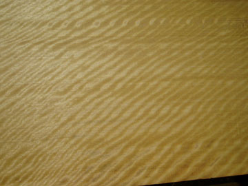

PostPosted: Thu Aug 31, 2006 11:24 am
Posts: 2217
This is Ceylon satinwood (chloroxylon swietenia).
It is very dense and beautiful!!
